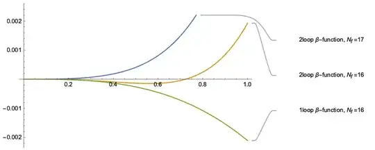

I believe this is heuristically the right idea: as you mention in the comments though there are some technicalities with whether asymptotic freedom and confinement are 1-to-1, and there are also some issues when you start looking at the two-loop beta function that lead to some surprises. A good paper to look at is this lattice study (Appelquist, Fleming, Neil), which investigates numerically the behaviour. I'll summarise what I believe to be the main points below:
The beta function of massless QCD has an expansion: $$\beta(g) = -\frac{1}{16 \pi^2} \left(\frac{11}{3}N_c -\frac{2}{3} N_f\right) g^3 - \frac{1}{(16\pi^2)^2} \left(\frac{34}{3} N_c^2 - \frac{1}{2} N_f \left(2 \frac{N_c^2-1}{N_c} + \frac{20}{3}N_c\right)\right)g^5 + \cdots$$ If we look at just the $g^3$ one-loop term, indeed there is a cutoff where $\beta(g) > 0$ for $N_f > 16$ and $\beta(g) < 0$ for $N_f \leq 16$. Including the two-loop $g^5$ term however introduces a zero to the beta function: enter image description here So, when you go to the infrared instead of the coupling getting larger and larger, you flow instead to the conformal fixed point. We can imagine though that the exact values of $N_f$ for which this fixed point exists depends on higher loop corrections too - that's why the lattice study was done to see for which $N_f$ this conformal fixed point exists (this is the `conformal window'). In the lattice study, they end up finding that $12 \leq N_f \leq 16$ has the fixed point, and $N_f \leq 8$ has confinement.
