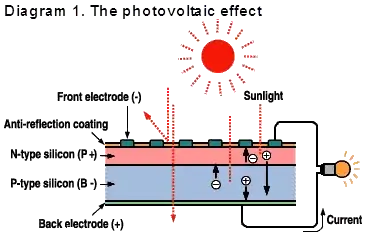

Essentially, a photon (solar or otherwise) striking the solar panel can create an electron-hole pair (EHP) and, if the EHP is within or near the depletion zone, the pair will be separated by the built-in electric field.
This results in a separation of charge and with that, a voltage across the panel. If there is an external circuit connected, there will be an electric current through the circuit.
But, if there is no external circuit through which an electric current can circulate, the electric field due to the separated charge opposes further separation of charge; the generated electron-hole pairs simply recombine rather than separate.
