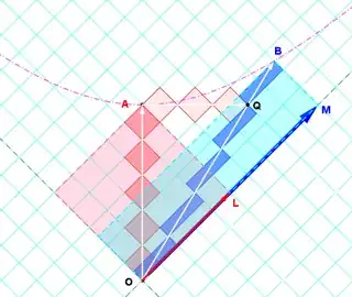

UPDATE2: Hopefully, this diagram will provide some spacetime-geometric intuition.
Regard the diagram below as a spacetime-diagram (with time running upwards).
The effect of an active Lorentz boost transformation takes the pink diamond with the red diagonal to the cyan diamond with the blue diagonal.
  • O gets mapped to itself, A gets mapped to B (another point on a hyperbola [of radius 5]), and L gets mapped to M (along the light cone, a hyperbola of radius 0).
  • The velocity $v=(3/5)c$, which corresponds to time-dilation factor $\gamma=\frac{1}{\sqrt{1-(v/c)^2}}=\frac{5}{4}$ and Doppler factor $k=\sqrt{\frac{1+(v/c)}{1-(v/c)}}$=2. These numerical values can be read off the diagram: $(v/c)=\frac{AQ}{OA}=\frac{3}{5}$, $\quad$ $\gamma=\frac{OA}{OQ}=\frac{5}{4}$, and $\quad$ $k=\frac{OM}{OL}=2$. (Note the diamond area is unchanged since the determinant of the boost (which equal the product of the eigenvalues) equals 1. So, the stretch by $k=2$ in one lightlike direction has a shrinking by the same factor along the other lightlike direction).
RRGP-robphy-Doppler-boost
Now regard this as an energy-momentum diagram (with energy running upwards).
  • $OA$ is a momentum 4-vector of a particle with invariant mass 5 units. $OL$ is a momentum 4-vector of a photon with relativistic energy 2.5 units [and relativistic momentum 2.5 units, so its invariant mass is zero units].
  • Under an active boost, the corresponding momentum 4-vector of the photon is scaled by the Doppler factor $k$ (that is, $OM=k(OL)$) so that the boosted photon has relativistic energy of $k(2.5)=2(2.5)=5$ units. Since the relativistic energy is proportional to its frequency ($E=\mbox{(const)}\omega$), the frequency of the boosted photon is now $k$ times its frequency in the original frame.
    Interpret it this way.
    If the forward-directed photon in the rocket frame had relativistic energy 2.5 units, then in the lab frame (where the rocket has velocity $(3/5)c$), that forward-directed photon has relativistic energy $k(2.5)=5$ units.
I hope this gives some quantitative intuition.
(See my other answer to directly connect with "period" and "wavelength".)

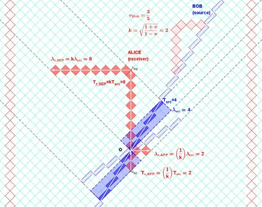

Rather than add to or edit my first set of answers (which focused on the Doppler factor as an eigenvalue that was used to scale the 4-momentum of a light-signal and also emphasized that length-contraction is not directly involved), this answer tries to directly connect the Doppler factor to the properties of period and wavelength.
Consider a source with velocity $v=(3/5)c$. The corresponding Doppler factor is $k=\sqrt\frac{1+(v/c)}{1-(v/c)}=2$.
If the source emitting signals at every 4 of its ticks ($T_{src}=4$), then the corresponding wavelength in the source frame is gotten from $\lambda_{src}/c=4$). I'm going to drop the $c$'s out of convenience.
The spacetime diagram (with "rotated graph paper" to help visualize the tickmarks along worldlines) shows the periodic source and the light-signals (which can be associated with wavefronts).
This diagram is drawn by Alice who is at rest in this frame. She meets Bob (the source) at event $O$.
RRGP-robphy-Doppler-period-frequency
In this frame, if a receiver at rest detects the backward-directed signals, the source is moving away from the receiver ("the separating case").
  • Two successive backward-directed signals are detected by Alice at events $O$ and $A_{RB}$. Alice measures a period between receptions $T_r = k T_{src}=(2)(4)=8$. (After Bob passes Alice at O and continues to separate, Alice takes 8 hours to watch [in slow motion] a 4-hour show broadcasted by Bob.) Alice measures a spatial separation $\lambda_r =k \lambda_{src}=(2)(4)=8$ (along a line of events simultaneous with the second reception event $A_{RB}$ according to Alice). As a check, Alice measures the speed of the light-signal to be $\lambda_r/T_r=c$.
  • Since the observed-period is longer by the factor $k$, the observed-frequency is lower $f_{r}=\frac{1}{k}f_{src}$, which corresponds to a "redshift". Since the energy is proportional to the frequency, the observed-energy is lower. Similarly, the observed-wavelength is longer by the factor $k$, which also corresponds to a redshift. Since the momentum is inverse-proportional to the wavelength, the observed-momentum is also lower.
  • We will argue that, on an energy-momentum diagram, the 4-momentum of the light-signal for a separating source is proportional to the shorter edge of the blue causal diamond in this frame, which corresponds to a less-energetic light-signal compared to the energy in the source-frame.
In this frame, if a receiver at rest detects the forward-directed signals, the source is moving toward the receiver ("the approaching case").
  • Two successive forward-directed signals are detected by Alice at events $A_{RF}$ and $O$. Alice measures a period between receptions $T_r = \frac{1}{k} T_{src}=\frac{1}{2}(4)=2$. (Before Bob passes Alice at O and continues to approach, Alice takes 2 hours to watch [in sped-up motion] a 4-hour show broadcasted by Bob.) Alice measures a spatial separation $\lambda_r = \frac{1}{k} \lambda_{src}=\frac{1}{2}(4)=2$ (along a line of events simultaneous with the second reception event $O$ according to Alice). As a check, Alice measures the speed of the light-signal to be $\lambda_r/T_r=c$.
  • Since the observed-period is shorter by the factor $k$, the observed-frequency is higher $f_{r}=kf_{src}$, which corresponds to a "blueshift". Since the energy is proportional to the frequency, the observed-energy is higher. Similarly, the observed-wavelength is shorter by the factor $k$, which also corresponds to a blueshift. Since the momentum is inverse-proportional to the wavelength, the observed-momentum is also higher.
  • We will argue, on an energy-momentum diagram, that the 4-momentum of the light-signal for an approaching source is proportional to the longer edge of the blue causal diamond in this frame, which corresponds to a more-energetic light-signal compared to the energy in the source-frame.

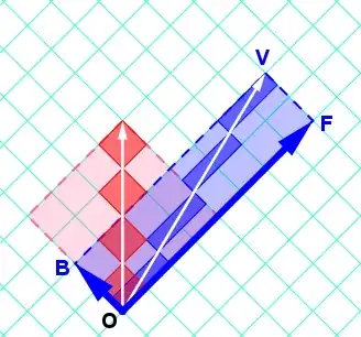

Next, consider the following diagram.
RRGP-robphy-diamond-edges
  • If the source were drawn in the source-frame, it would correspond to the red diamond. (When $v=0$, then $k=1$.)
  • But since the source is drawn in Alice's frame, where Alice measures the velocity of the source to be $v_{Bob}=(3/5)c$, it corresponds to the blue diamond [here and in the previous diagram].
  • The effect of the Lorentz boost transformation preserves the edges of the diamond (lightlike directions are eigenectors) and preserves the area of the diamond (since the determinant of the boost [product of eigenvalues] equals 1). The eigenvalues are $k=\sqrt\frac{1+(v/c)}{1-(v/c)}$ and $1/k$, with $k=2$ for $v=(3/5)c$.
  • So, the blue diamond edge $OF$ is the scaled up edge: it is $k$ times the corresponding vector on the red diamond, and the blue diamond edge $OB$ is the scaled down edge: it is $1/k$ times the corresponding vector on the red diamond.
  • Thus, on a similarly-drawn energy-momentum diagram, the 4-momentum of the more-energetic light-signal from the approaching source is proportional to $OF$ (see the vector $OM$ in my first answer), and the 4-momentum of the less-energetic light-signal from the separating source is proportional to $OB$.
Hopefully, this answer connects the Doppler effect with "period" (and thus frequency) and "wavelength", and thus the energy and momentum as components of the 4-momentum of a light-signal.
