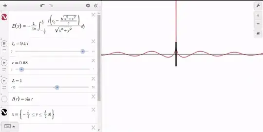

Here's a demonstration of the equation graphed in Desmos,
Desmos
So to reiterate, is my derivation and final equation correct? Did I miss any steps? Did I oversimplify anything? Any insight and help would greatly be appreciated.

This should be the solution. I am not very used to work with waves green function´s, but i dont think you can use one of them in this kind of problem. Let me know if you graph it. Hope it works.
