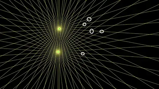

this image shows two point source of light
As we can see, in above image there are two point sources (for practical purposes I am considering it as point sources because all the light rays from them are diverging) you can see that :
There are several points in space where light rays from them are crossing each other in space, it means they are getting mixed (by mixed I mean if the light rays from "different" objects focus on one single point on retina when rays from them will enter eye rather light rays from each object separately), but still we can distinguish both sources separately and at the same time we can also see the illuminated space around them.How is it even possible? How we can see the brighten space as well as distinguish both sources?
I have taken only two sources but in actual life, there are many objects in room which reflects off light and all of their rays are getting mixed in space before entering eyes still our eyes (or brain) is able to distinguish which rays are coming from which object.How?

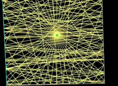

For me, everything should look like a uniform mess of illumination like this:
uniform mess of brightness

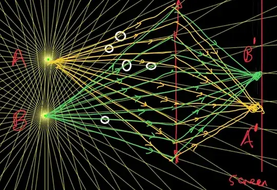

for me everything should look like a uniform mess of illumination like this: . . . shows an incorrect diagram.
A ray is the path taken by light.
Assume that without a change in refractive index light travels in straight lines.
That where light rays cross there is no "interference" between the rays.
In other words one ray is totally ignorant of what the other ray is doing and when rays cross they do not deviate in direction.
I have added to your second diagram to show a selected number of rays from the two sources passing through a convex lens and hitting a screen, which could be your eye with the retina as the screen) to form real images $A',B'$ on the screen of sources $A,B$.
In spite of rays crossing over what is seen on the screen is two distinct images of the sources.
Where you have placed white circles to show where rays cross makes no difference as far as the passage of the rays is concerned, they carry on travelling in the same direction as before.
Rays reflected/scattered off walls will produce similar images of the walls.

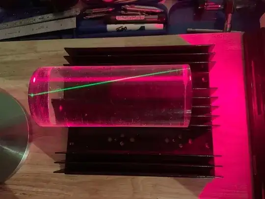

The photographs show the result of @EdV using two laser pointer beams, red and green, intersecting without interacting, inside a large plexiglass rod. The green laser is attenuated with a ND 2.0 filter and the plexiglass just facilitates seeing where the beams are.

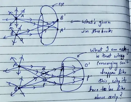

In short: light rays emanating from an object carry two pieces of (mathematical) information. An angle and a position.
When an input light ray hits a lens the angle and position of the output ray depend on both the angle and position of the input ray. For example, a ray colinear with the optical axis passes through undeflected while a ray parallel to the optical axis, but off axis, will deflect by an angle depending on how far off axis it is and the focal length of the lens.
This helps explain why multiple rays emanating from a single object and hitting a lens at different positions and angles can focus all rays down to a single point.
Likewise, it explains why separate rays from two different objects that hit a lens at the same position (but different angles) or that hit your eye with the same angle (but different position) can get focused down to different points behind the lens.
Finally, take care that you recall that the human eye (as well as most cameras) consist of TWO optical elements. A lens followed by a detector screen (the retina in the case of your eye or a ccd or cmos sensor in the case of a digital camera.) If instead you only had a screen then you would only see position information about the rays and indeed any point source would illuminate the entire screen rendering any two point sources entirely indistinguishable.
The answer to your question: we can distinguish objects using light rays because the lens in our eye works to convert the angles and positions of rays from distinct objects into distinct spots on the retinas in our eyes.
Note that this property of lenses (focusing light from distinct objects onto distinct points) only works for certain shaped refractive materials. In particular it works for a lens that has an approximately parabolic shape. Fortunately a spherical shape approximates a parabola well enough for this property to be realized. But if you instead had, for example, a triangular or quartic or something lens this property would be more and more spoiled (this is related to optical aberration). Note also, of course, that the distance between the screen and lens compared to the focal length matters as well.

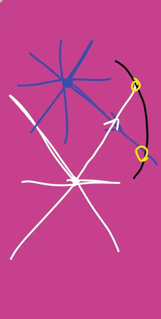

I think I understand your question, but I don't think your diagrams[or you] explain your issue well.
Here is a picture of an "eye", where white light from one source, and blue light from one source, do infact hit eachother at the same point in the retina, which I have circled in yellow
You would be absolutely correct, that this picture of an eye, would yield completely blurred images and you would not be able to see anything.
This is why the eye has developed a natural pinhole camera.
Here is an image of an eye with a retina. Notice how the case where the light from the 2 sources mix, is now blocked by the retina! [Which I have circled in yellow]
The pinhole shape, means that light entering one spot in the retina, can only enter the retina on that spot, if it comes in from the SAME angle.
Thus, you have a spatial location dependance, on light that enters the retina on a certain spot. Our brains can then make image.
It is the retinas job to make sure that light entering the retina at a certain spot, only comes from a certain angle, thus eliminating the possibility of light "mixing" from 2 different locations.

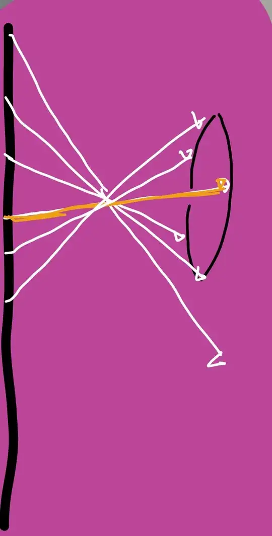

Here is a better diagram of your situation in your previous question. I can always cherry pick certain rays that "converge" to a single point in space. And then I'm guessing you say "why doesn't the eye say the objects at that convergent location". Simple answer is clear from the diagram, only 1 ray will make it into the eye which registers as light coming from a certain angle.
I can artificially Cherry pick more rays that converge to another location and then only 1 ray survives.
I have highlighted the ray that makes it into the eye in orange.
Doing so for many "convergent" rays, will just say light is coming from all angles associated with the e.g wall, and the brain registers a wall.

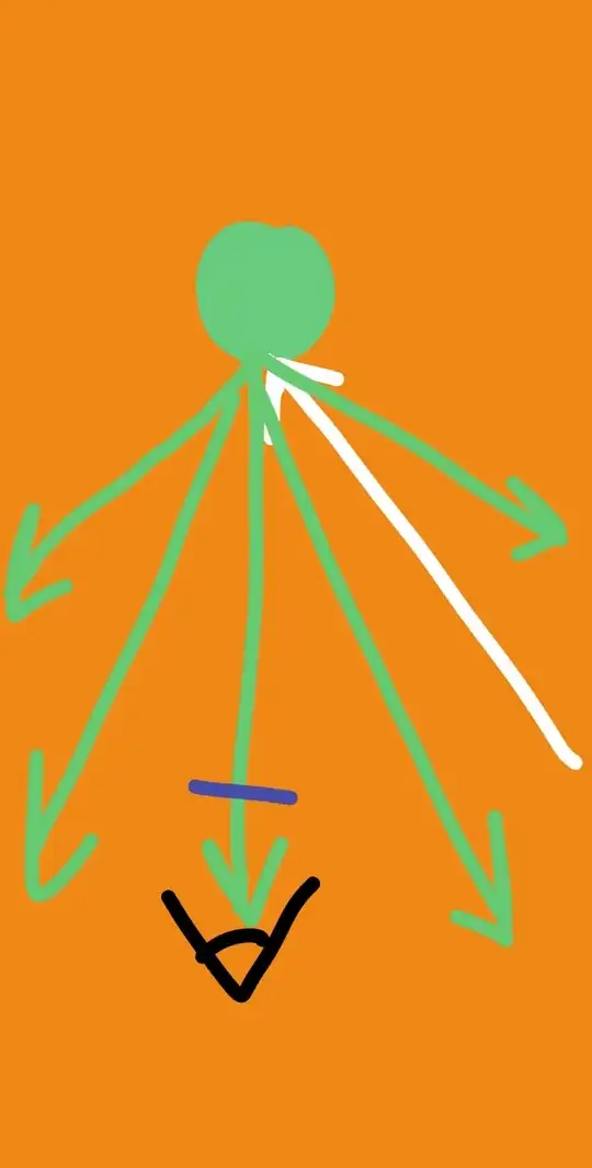

When light is incident at object. The light can either be absorbed, speculary reflected, or scattered.
A green object, Absorbs all light apart from green, and then scatters green light in all directions.
This green light then travels to my eye, and my brain processes it as a "green object".
The light scattered from the green object that does not travel towards me, does not get registered by my brain, and therefore I will not see those rays.
I hope everything upto this point is clear.
You talk about "mixing light rays" and then draw a diagram of those rays and then I presume you think that we see those rays? We do not.
We do not see light that doesn't directly travel from the source to the eye in straight lines.
Light rays do not interact with eachother.
The reason that the "entire room" is lit up, is because the rays that do not directly enter our eye, are incident on something like a wall.
The rays from that green object that miss our eyes, instead reach the Wall, get absorbed and remitted by the molecules the wall.
The light from the wall gets scattered in all directions, the rays from the wall that don't travel directly to our eye We don't see. The rays from the wall that DO travel directly to our eyes, we do see.
The light from the wall is registered by our brains as what ever colour the wall happens to be.
Ofcourse the light directly from the torch ALSO gets directly scattered by the wall aswell (along with the light scattered off the green object)
This is also a reason why if you put a green object close to a wall, the wall appears slightly greener. The light from the green object is scattered by the wall, so that our brains register the wall having a greener tint to it. As there is more greenlight that is now scattered, in addition to the variety of light scattered by the torch.
For simplicity I have only added a single point of scattering
Here we have white light that is incident an object. When it hits the object, light scatters in ALL directions. The light the enters the eye, is the ONLY light that I see. no mention of "the light ray that doesnt enter acts as another source that propagates to the eye," this is wrong.
So as of now, if I were the eye, I would register the only light I see, is a green object(or a single point of green as I have only included a single point of scattering), and the rest of my vision is black. This is similar to the sun in space. In space everything is black, apart from the point at which the sun is, as the rays from the sun move in straight lines towards my eyes.

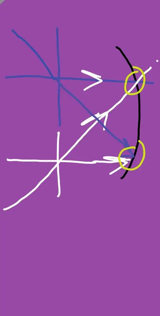

Huygens principle is what is confusing you I'm pretty sure. This is already accounted for in the fact that you consider the net EM wave propagating and not a single element, these cancel out the apparent "source" of light from a direction not travelling straight toward you
Mixing elements:
There is no trouble in "unmixing" if the rays Cross paths, light does not interact with light so it doesnt effect anything.
In the diagram you see 2 light rays crossing paths. The eye will not see the rays as coming from the same location.
In the diagram I have drawn a huge eye in black and have circled where the eye registers each ray on the retina in yellow. The eye picks up the light at different locations on the retina and will perceive the light as coming from 2 distinct locations, ie , the places I have drawn on the diagram.
