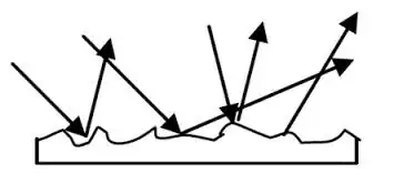

Yes. It's is not so much the water is the beach sand reflecting light back to you like a parabolic mirror. The droplets of water on your skin can form more surface area to catch light creating a magnifying effect focusing light on your skin as well. The random texture in the beach sand will also give you even tan. Most sand is white in color even if not the water and sand in its natural state are glossy where dirt or grass absorb more of the spectrum of light including UV light.
