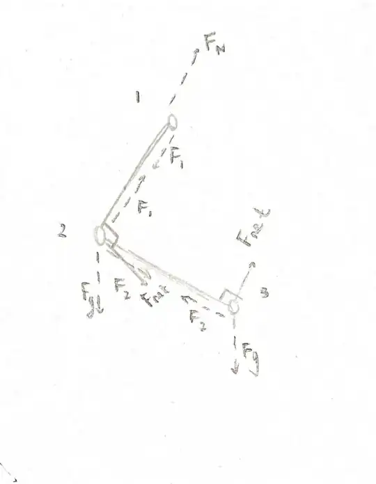

First, at a certain frame, calculate the net force on each node. For a very small change in time, 3 essentially rotates around 2, and 2 around 1. So, the net force must be entirely perpendicular to the previous bar. As such, I can work backwards: first we know the gravity on three, and I know the angle relative to 2, so I now know both the net force and Tension 2 (which must cancel with a component of gravity), then we repeat up the chain.
Figure 1 My goal is to get the net angular acceleration on each node so I can do a double riemann integral (I have angular position and velocity relative to the last node stored for each node). angv += anga * dt, angx += angv * dt

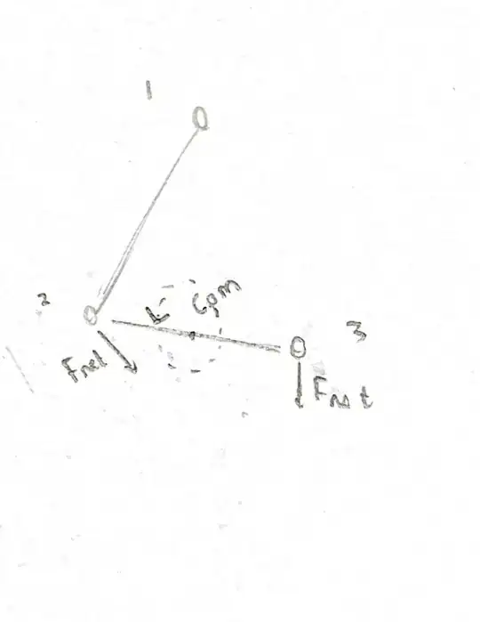

  1. Then, we have the net force at each node, here's what I've been playing around with. For each rod, calculate the net angular acceleration on both ends and then since the previous node doesn't move (for a small dt), that angular acceleration is equal to the a.a. around the last node and not just the center of mass. I think the error here was that this started swinging with both nodes always in line if you started it perfectly horizontally Figure 2

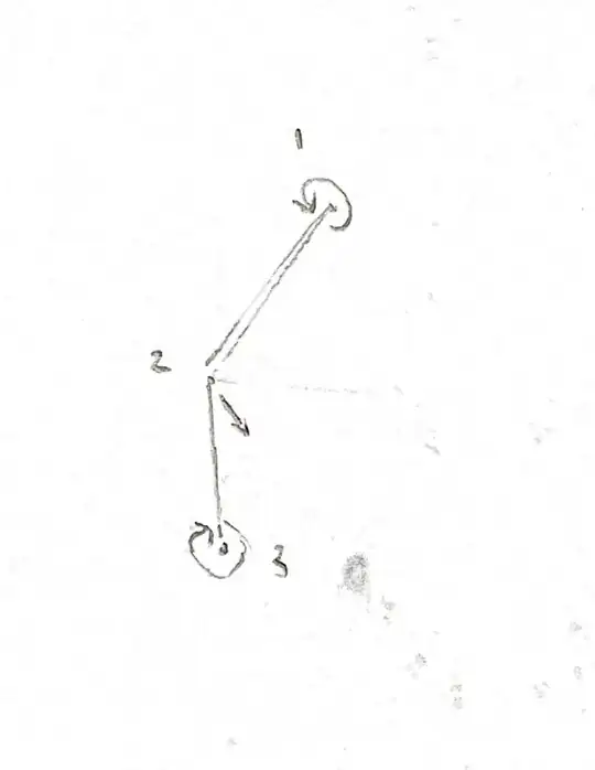

  2. Because of the error, I decided to elapse time one at a time instead of on both ends of the rod. I moved a node a little bit, then calculated the angular acceleration on each of the rods to calculate their new angular positions. Figure 3

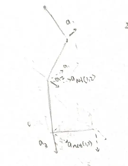

  3. I then realized that let's say the previous nodes had a sudden movement, then the net acceleration on that node would be affected, so I calculated the net acceleration on each node then did vector addition for the previous nodes up to the current node and then did the same rod calculation as 1) Figure 4
