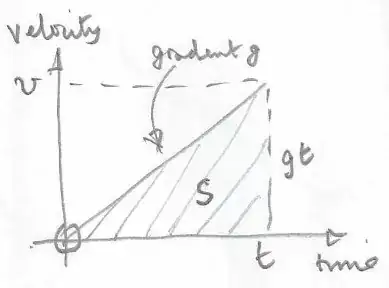

We know that according to law of free falls object, all bodies fall with the same constant acceleration. But in distance formula ($s = \frac12 gt^2$), why the acceleration is just half?
Zeyar
  • 25
The straight line graph of velocity against time for constant acceleration from zero velocity is shown below.
The area under such a graph (a triangle) is the displacement, $s = \frac 12 \cdot gt\cdot t = \frac 12 gt^2$.
Note that the average velocity is $\frac{v-0}{2}$ and so the displacement is $s=\frac{v-0}{2}\cdot t = \frac {gt}{2} \cdot t = \frac 12 gt^2$ as before.

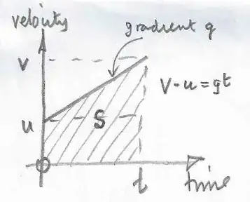

If there is an initial velocity $u$ then the displacement (tapezium or triangle plus rectangle) is $s = ut+\frac 12gt^2$ which can be found using the graph below.
