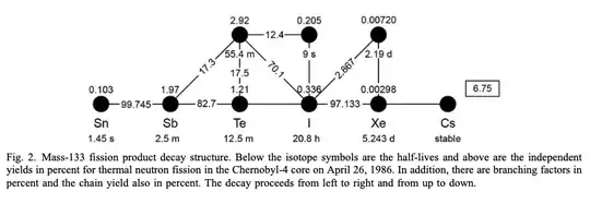

The three authors of this paper, from the Swedish Defence Research Agency, Meteorological and Hydrological Institute and Stockholm University, have done this accurately for the RMBK reactor type used in Chernobyl and have estimated a branching ratio for these two isotopes under differing power levels and thus what might be expected to be present within the reactor. The authors furthermore claim that the code used to produce this estimate is experimentally validated. Below are the expected branching ratios for thermal neutron fission in the reactor:
Decay chain leading to isotopes of Xe-133

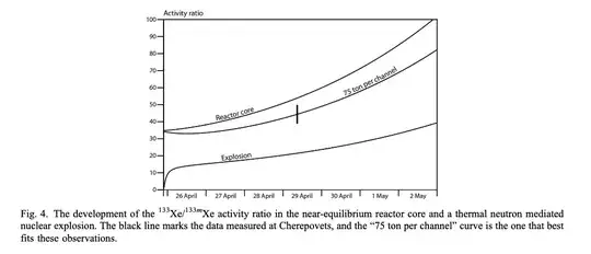

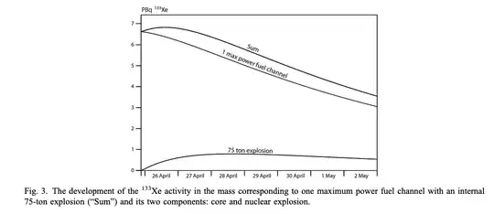

The authors then have the ability to try different scenarios in the distribution of the reactor core, and look at the production of $^{133}$Xe (or $^{133m}$Xe). One of the scenarios they examined is that one reactor rod had a prompt criticality incident and produced a nuclear explosion with an energy release equivalent to 75 tons of TNT. The reactor is destroyed in this process, and the ratios of the two isotopes then decay back towards equilibrium:
Xe-133 production over time.
Now, the interesting thing about this is that the ratio experimentally detected in Cherepovets happens to line up almost exactly with this scenario, and it is claimed that it is not possible to easily explain it any other way, given the known time delay between explosion and detection, and the unambiguous determination of the isotopes (via gamma-ray spectroscopy):

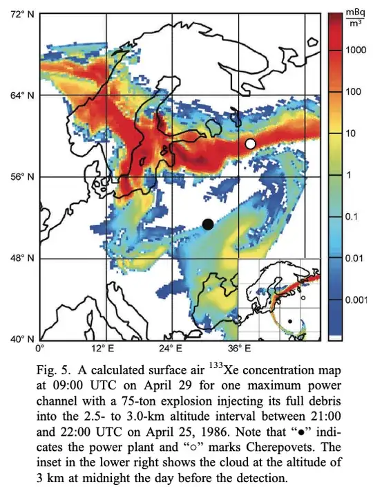

Branching ratios
The authors of this work also claim that another significant piece of experimental evidence comes from the curious fact that Cherepovets is far to the north/northeast of Chernobyl, yet the majority of the fallout and dispersed isotopes was observed went to the west and northwest, causing (famously) "radioactive sheep" in Wales, amongst other issues en route over Scandinavia. We have got a lot better at weather forecasting since the late 1980s, and again the authors of this work use historical observational data and modern models to simulate what may have occurred. They claim that a these simulations show, as a function height, that a significant fraction of the large amount of liberated radioactive fission products at low altitudes would head northwest toward Scandinavia but, at higher altitudes made a sharp turn back east around the Gulfs of Riga and Finland. This would permit them to explain the geographical distribution of $^{133}$Xe/$^{133m}$Xe that matches with the measurement made in Cherepovets, by having a jet of nuclear material reaching about a 3 km altitude:
Distribution of Xe-133
