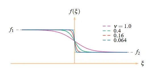

with $\nu>0$ the kinematic viscosity. If we look for a traveling wave solution, i.e., a solution of the form $u(x, t)=u(x-c t)=u(\xi)$, where $c$ is the speed of the traveling wave, then we find that it is given by the following equation (as proved here), $$ u(x, t)=c-\frac{1}{2}\left(u_{1}-u_{2}\right) \tanh \left[\frac{1}{4 \nu}\left(u_{1}-u_{2}\right)(x-c t)\right], \tag{2} $$
where $u_1$ and $u_2$ are two constants representing the height of the solution $u(\xi)$ for $\xi \rightarrow - \infty$ and $\xi \rightarrow + \infty$, next to next. It is said that this solution represents a shock wave, since it joins the asymptotic states $u_1$ and $u_2$ and, for low values of $\nu$, it allows discontinuities to form. It is said that the viscous Burgers' equation is a good model to investigate the behavior of shock waves. enter image description here
However, besides the fact that it admits the solution $(2)$ in the form of a shock wave, what else could we say in this regard? Does the Burgers equation have any other application to the study of shock waves? Would the above solution have any physical significance (could it perhaps represent a wave along a pipe or something similar)?
