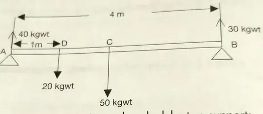

In the system of parallel forces , all the forces are non-colinear. So how to they balance each other?.enter image description here
Here in this case a wooden plank is supported at its end by two supports. All the forces here are non-colinear. So how do the tension in that supports balance the weight of plank?

In order for the plank to be in equilibrium, the sum of the vertical forces must be zero and the sum of the moments about any point on the plank must be zero. There are no horizontal forces.
This means the sum of the upward reaction forces at A and B must equal the sum of the downward applied forces at D and C, and the clockwise moments about any point must equal the counterclockwise moments about the same point.
For example the clockwise moments about A due to downward forces C and D must equal the counterclockwise moment about A due to the upward reaction force at B. That will be the case if the distance between C and D is 1 meter (it isn't shown in the diagram)
