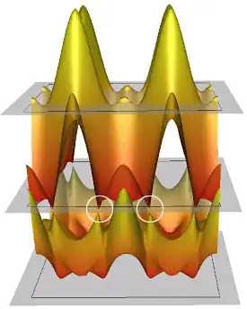

This nice image of Dirac cones (from this article), in a ($E,\vec k$ graph) will be an introduction for several questions, in the realm of topological insulators.
1) Does the Dirac cone appears only at the surface ?
2) Is the shape (the cone) important ?
3) The Dirac cone is gapless, so is it only stable by symmetry-protection ?
4) Suppose a Dirac cone is opened, then closed, then re-opened. In the open situation, there is a energy gap, so there is a possible non-trivial topology. So it is possible to change the topology in the open->close->open process ?

1) Dirac cone's on surface: Some emergent Dirac cones appears in the bulk of the $p$-wave chiral superconductor, see the book by Volovik for more details, available freely on his homepage at Aalto University. I'm not at ease with the notion of band structure on the surface. I have no idea what it means... That's just the closure of the gap which happens on the surface/edge for me. [-> Please see the Heidar comments for a clever discussion <-].
1-bis: the topological insulator situation. The topological insulator case is easier to discuss, since a bulk insulator has no closure of the gap by definition. Then, the Dirac-linear-closure can only happens at the edge. See also point 4 below, and the Heidar's comments about the Jackiw-Rebbi model below.
