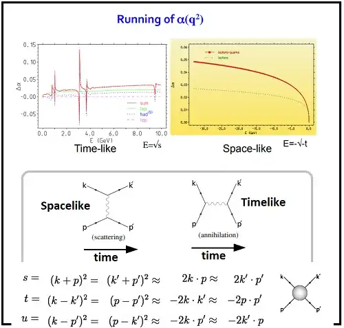

However, elsewhere I find that the accepted value of the fine structure constant $\alpha\approx1/137$ is really $\alpha(511\text{keV})$, not $\alpha(0)$. Since L3 is measuring the momentum transfer $Q$ in GeV, are they simply ignoring the 511keV? If not, what is the difference between the true $\alpha(0)$ and the $\alpha(511\text{keV})$? Although I understand the difference is small, which $Q^2$ is measured to satisfy the usual value $$\alpha(Q^2)= \frac{e^2}{4 \pi \varepsilon_0 \hbar c}~~?$$ Furthermore, I would like some clarification on the meaning of momentum transfer "in the timelike region" or "in the spacelike region." From my reading, I understand that these are the cases of annihilation or scattering in an $e^-e^+$ scattering experiment where the photon exchanged moves through a timelike or spacelike region (pictured below). However, I would like some clarification on what they mean by "momentum transfer in one region or the other."

The "momentum transfer" terminology for $Q^2$ refers to a popular way of assigning energy scales to tree-level diagrams according to the momentum the virtual particle "should have had" if we impose energy-momentum conversation: In terms of Mandelstam variables (see also this answer by JamalS), for an s-channel diagram, this is $Q^2 = s$ and $s$ is positive, for a t-channel diagram, this is $Q^2 = t$, and $t$ is negative. If you now think about $Q$ as an actual 4-momentum, $Q^2>0$ means it's timelike and $Q^2<0$ means it's spacelike (or the other way around, check your metric sign convention!), but in any case this leads to calling s-channel contributions "timelike" and t-channel contributions "spacelike".
