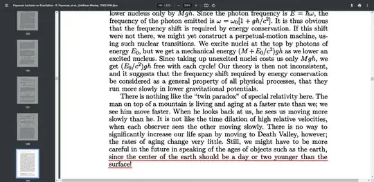

Side note: just for the hell of it, I used J. B. Hartle's equation instead of U.I. Uggerhøj's to calculate the age difference between the Earth's centre and surface, and got a difference in days instead of years, which interestingly fits Richard Feynman's prediction, which Uggerhøj believes is wrong. enter image description here
