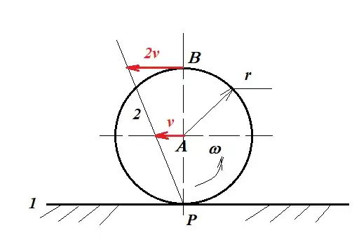

Say we have a cylinder rolling without slipping on a horizontal plane: enter image description here
Now, the instantaneous centre of rotation is P, so we can use $ v_A=\omega \ r_{AP}$ to find the linear velocity of the centre of mass, and calculate: $$\mathrm{KE}_{\mathrm{translational}} = 1/2 mv_A^2$$
However, my question is to do with computing the rotational KE. If P is the instantaneous centre and the cylinder is rotating about P, then why do we not use moment of inertia about P in the equation for rotational KE?
Why is it $\mathrm{KE}_{\mathrm{rotational}} =1/2I_A \omega^2$ and not $1/2 I_P \omega^2$?
The moment of inertia in rotational KE is defined to be the moment of inertia about the axis of rotation. Now I can see, of course, that the cylinder's axis of rotation over the course of its motion is A. However, isn't the bottom of the cylinder in contact with the ground always an axis of rotation too? What am I missing here?

The rotation/translation decomposition depends on the axis of rotation that you choose. If you consider the cylinder to be rotating about $A$ as it translates, $$\text{KE}_\text{translational}^A = \frac 1 2 m v^2$$ $$\text{KE}_\text{rotational}^A = \frac 1 2 I_A \omega^2.$$ If you choose $P$ as the axis of rotation, the instantaneous motion is purely rotational, i.e. there is no translation: $$\text{KE}_\text{translational}^P = 0$$ $$\text{KE}_\text{rotational}^P = \frac 1 2 I_P \omega^2.$$ In either case, the total kinetic energy is the same, as you can verify using the parallel axis theorem and the fact that $v=\omega r$.
