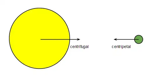

Newton's third law tells us that action and reaction are equal and opposite, so the gravitational force between e.g. the Sun and the Earth pulls equally on both bodies:
CentralForces
The Sun moves a lot less, but that's because it's a lot heavier than the Earth. In fact both the Sun and the Earth are accelerating towards their mutual centre of mass so there aren't inwards and outwards forces - both forces are inwards towards the centre of mass. Anyhow, we call the (apparently) outward force on the Sun the centrifugal force from the Latin for fleeing the centre. The (apparently) inwards force on the Earth we call the centripetal force from the Latin for seeking the centre.
