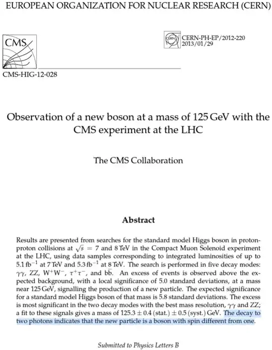

I tried searching the internet for explanations of why that decay shows the spin of the Higgs boson is different from one, but I cannot get a straight answer. It must be something quite trivial as the original discovery paper in July 2012 simply stated in its abstract that "The decay to two photons indicates that the new particle is a boson with spin different from one" which can be found here after selecting the appropriate title paper which looks like:
Higgs original discovery paper
So, just to summarize, why does the Higgs diphoton decay prove that the spin of the Higgs is different from one?
