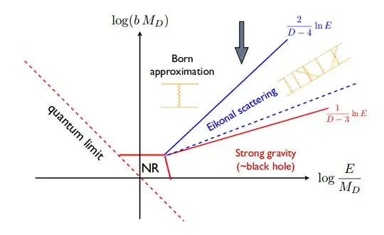

Yes, OP is right:
  • From the HUP the region below the hyperbola $$E b \lesssim \hbar c$$ in the $(b,E)$-diagram is in the quantum regime.
  • For constant COM energy $E$ and growing impact parameter $b$, the tree-level scattering/Born-approximation should become better and better (except for an IR divergence of soft-gravitons for spacetime dimension $D\leq 4$).
  • For constant impact parameter $b$ and growing COM energy $E$, classical black holes should form.
For a more detailed discussion, see e.g. Ref. 1.
$\uparrow$ Fig. 3 from Ref. 1. Note that the axis are logarithmic and exchanged as compare to Fig. 1.1. $M_D$ is the Planck mass in $D$ spacetime dimensions. "NR" denotes an uncontrolled, non-renormalizable Planck regime.
References:
  1. S.B. Giddings, The gravitational S-matrix: Erice lectures, arXiv:1105.2036; Fig. 3 on p. 8.
