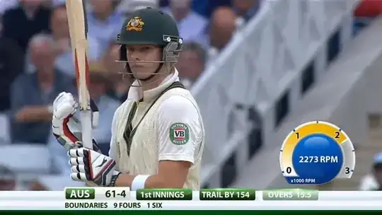

The 2013 Ashes series (a cricket thing between England and Australia) are underway as of today and it seems they have a new (to me) gimmick. It appears that they are now able to measure almost instantaneously (within a few seconds) the rotational speed of balls bowled by spin bowlers.

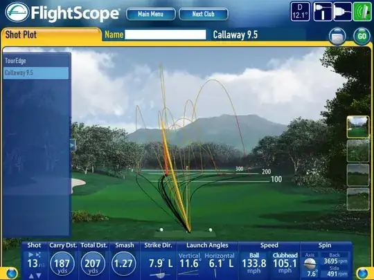

On the (golf) driving range, I was able to get similar readings, but they were from a machine only a few feet away from the tee. I don't quite understand that either, but it seems at least easier. Although there, they were even able to determine the rotational axis as well.

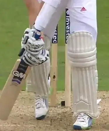

I think I now see that they placed very small black boxes between two of the stumps on either end of the pitch. I guess that must be the first two radars. (One of which will be useless because the batsman is standing in front of it.)
So, essentially: How do they do it? And, how accurate can it be, given that the reflection of the "sides" of the ball may be poor? Or are they using (visible-light) camera images, as suggested by the comments of udiboy and Deer Hunter below? (I'm fairly confident the golf system doesn't do that, but I don't know. Anyways, to make sure, the question is primarily about the cricket.)
