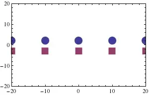

Following the suggestion of @BebopButUnsteady, I repeated the 'unit' of my system, the V-AV pair, until obtaining the following tiling pattern (vortices are circles, AVs are squares)
tiles

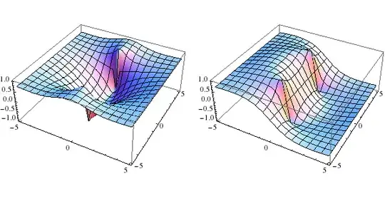

Let us first look at the real (left) and imaginary (right) parts of the wavefunctions for the initial V-AV pair:
initial-boundaries

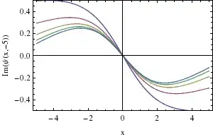

One can see that, especially in the imaginary part, the values on the boundaries are not equal. Now we start adding copies of the "unit cell" along the x axis, and plot a cut though the imaginary part of the wf:
boundaries-tiled
It appears that, as we increase the number of copies, the values at the ends get closer and closer to 0, which would be the ideal periodic case. Of course this is just numerics, I have no formal proof yet that this procedure actually converges.

You cannot have a total vorticity with periodic boundary conditions, since if you take a path around all of your vortices, it will have a non-zero circulation. But you have periodic bc, so you can continuously deform that path to a point, and a point has zero circulation.
Mirror images are not quite the same as in electrostatics. We want periodic boundary conditions. To get periodic boundary conditions you imagine tiling the plane with your system. This will trivially be periodic and so you can just take a tile, and work with that. So you want the mirror image of a vortex to be a vortex.
(In electrostatics you usually use mirror images to enforce not periodic boundary conditions, but to enforce constant voltage. That's why you flip the sign of the mirror charge. Here we want periodic b.c. If you flipped the sign of the vortices I believe you would get *anti*periodic boundary conditions, but don't quote me on that.)
