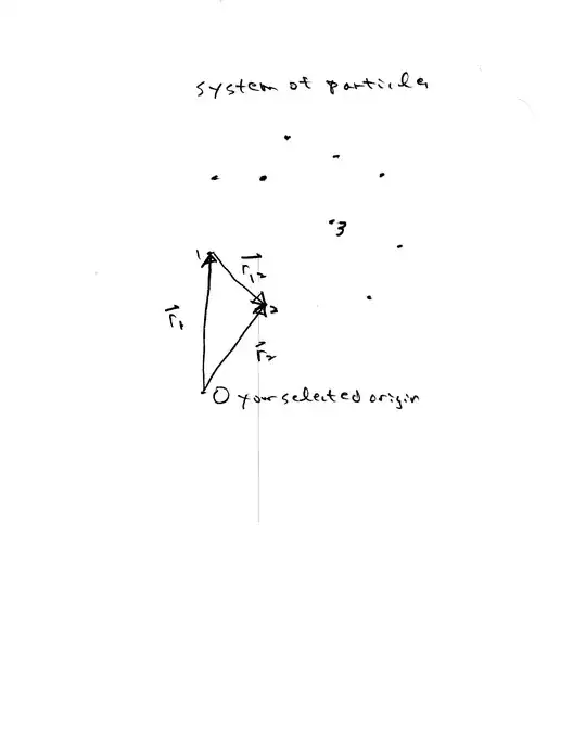

See the figure below. Consider any two particles: $1$ and $2$. Using $O$ as the point about which to evaluate torque, $\vec r_1 \times \vec F^i_{2 \to 1}$ is the torque on particle $1$ from particle $2$, and $\vec r_2 \times \vec F^i_{1 \to 2}$ is the torque on particle $2$ from particle $1$. Using the third law, $\vec F^i_{2\to 1} = -\vec F^i_{1\to 2}$ so summing we have: $(\vec r_2 - \vec r_1 ) \times \vec F^i_{1 \to 2}$. $(\vec r_2 - \vec r_1 ) = \vec r_{12}$ has direction along the line joining point $1$ to point $2$, and if $\vec F^i_{1\to 2}$ acts along this line, as we have required, the cross product in the sum is zero. Similar arguments can be made for the other internal torques so the total internal torque is zero.
As mentioned earlier for the general case, the internal torque on an individual particle is not necessarily zero; for two particles the internal torque on particle 1 from particle 2 is $\vec r_1 \times \vec F^i_{2 \to 1}$. But, the total internal torque, the sum of 1 on 2 plus 2 on 1, is zero. enter image description here
