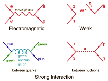

Exchange particles are mathematical constructs in the Feynman diagrams used to calculate branching ratios and cross sections for real interactions. The exchanged particles are virtual because although they have all the quantum numbers characterizing their name, their four momentum vector is off mass shell. All particles can be virtual within the Feynman diagrams, which are a valuable method of simplifying the writing of unique integrals for the reactions. The electrons too can be virtual in more complicated interactions.
feynman diagrams of exchange
The intermediate particles are virtual in all four diagrams, the end particles are real.
