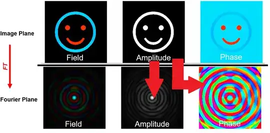

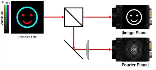

The setup in the video is as follows : some field (with amplitude and phase) is imaged on an image plane, where we get the image of the intensity of the field, but not the phase, and we would like to know that phase. So the field is also projected "in the far field", to get the image in the "Fourier plane". enter image description here
I get the gist of the rest of the algorithm pretty well, which involves comparing images in the image plane and the Fourier plane, enforcing constraints on the amplitude to iteratively correct the phase.

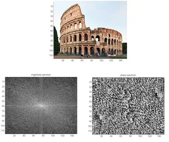

but what I don't get - and I think this is probably my lack of knowledge regarding Fourier optics speaking - is what truly is the "Fourier transform" discussed here. From my image processing background, the Fourier transform decomposes an image, i.e. a real signal, function of space, into an amplitude and phase image in frequency space. Something like :
So, I first thought that the Fourier transform discussed here was decomposition happening between the "image plane"'s intensity and the "Fourier plane"'s intensity + amplitude, ie the red arrows I've added to the figure.

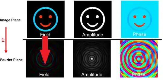

However, that doesn't seem right, because the phase information seems to be taken into account during the Fourier transform. But then, what does the transform indicated by the following red arrow mean ? The field has both phase and amplitude information : is it in frequency space ? does it carry the same information as the phase and amplitude of the Fourier transform (ie the two right images on the bottom row) ? What does it mean to take the Fourier transform of a such a signal ?

are you familiar with Fraunhofer diffraction? This is what is physically happening in your first picture as the light passes through the lens. The idea is that it is the new light field that is rigorously the 2D Fourier transform of the original one. However, in the end, you only measure intensity, i.e. the (square) amplitude.
Therefore, the first measurement is the amplitude of the field, the second measurement is the amplitude of the Fourier transform of the field. Combining both you can extract information on the phase of the initial field. Just to make it clear, this does not correspond to the amplitude of the Fourier transform of the amplitude of the initial field as you seem to suggest in the second picture (it would not even give any relevant information as you noted yourself).
Hope this helps and please tell me if there are any mistakes.
(Edit following @Solitus' comment)
I'll write explicitly the math behind my explication. Physically, your light is the EM field, a vector field, but in your case, you approximate it by a scalar field. Since it is regulated by a real linear second order in time differential equation, just as for the harmonic oscillator, you condense the field and its derivative by a single complex field $U(x,y)$ (complex amplitude). The intensity is therefore (up to a multiplicative constant) $I(x,y) = |U(x,y)|^2$ and the phase $\phi(x,y) = \arg(U(x,y))$.
Physically, you only measure $I$ with a photodetector, but you want $U$, so $\phi$. The trick is to transform $U$ and measure the new intensity in order to tease out information of $\phi$. The Fraunhofer diffraction transforms $U$ to $\mathcal F U$, the Fourier transform on a complex function. The second measurement is therefore of $|\mathcal F U|^2$ which is indirectly related to $\phi$. Heuristically, $U$ has $2$ real degrees of freedoms (per point), and you have two observables (per points), so you "should" be able to solve the equations to retrieve $U$. The Gerchberg-Saxton algorithm does this solve in a self-consistent loop.
To summarise, unlike image processing where the signals are real, in optics you are interested in complex signals.
