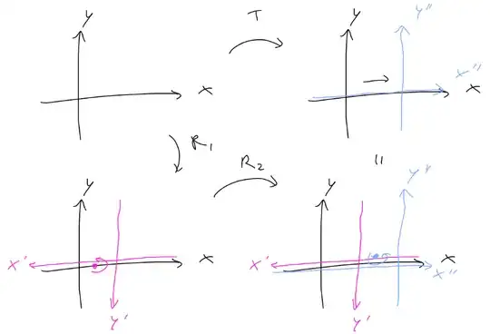

I want to build on John Rennie's answer, which invokes Nother's theorem, because it actually clarifies your idea beautifully. I will assume we are considering Euclidean space throughout the entire post.
Now rotational symmetry does not necessarily say anything about translational symmetry. To quote John Rennie here,
The two symmetries are not necessarily related so the two conservation laws are not necessarily related.
John Rennie rightfully invokes an example involving a system consisting of a spherically symmetric potential. For concreteness, we may consider the Coulomb potential $V(r) = A/r$ where $r$ is the distance from the origin and $A$ is some nonzero constant. This system has rotational symmetry about any axis going through the origin, and yet it very obviously has no translational symmetry.
However, there is a specialized case where a relationship between the two symmetries does exist. The key realization is that every translation in Euclidean space can be written as a composition of rotations. Because of this somewhat surprising fact, it follows that if we postulate rotational symmetry about every possible axis, then translational symmetry necessarily follows for free. In this specialized circumstance, there is a relationship between the two symmetries as you seem to be pointing out.
Again, I have to stress that this relationship only occurs in a special case. This explains why people seem to be talking past each other, and it also explains why no one is contradicting one another if you think about this carefully enough.
Returning back to my claim that every translation is a composition of rotations, I will demonstrate a case in two dimensional Euclidean space. The generalization is straightforward.
Lastly, it is crucial to understand that I will be talking about transformations in the active sense.
Suppose we have a translation of the form $T:(x, y)\mapsto (x+a, y)$. To write this in terms of rotations, define $R_{1}:(x, y)\mapsto (-x+a/2, -y)$ and $R_{2}:(x', y')\mapsto (-x'+3a/2, -y')$. Here $R_{1}$ is a counterclockwise $180^{\circ}$ rotation about the point $(a/4, 0)$, and $R_{2}$ is a counterclockwise $180^{\circ}$ rotation about the point $(3a/4, 0)$. The result, as one can check, is that $$ T = R_{2}\circ R_{1}. $$ We can even demonstrate this visually (again keep in mind these are active transformations acting on points).
To generalize, simply consider that any translation of the form $(x, y, z)\mapsto (x+a, y+b, z+c)$ is really just three translations $(x, y, z)\mapsto (x+a, y, z)\mapsto (x+a, y+b, z)\mapsto (x+a, y+b, z+c)$.
