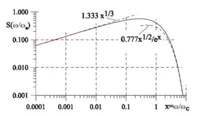

When electromagnetic radiation comes in pulses, as in synchrotron radiation, the pulse contains many frequencies because the angle of emission defines the radiation, and the angle is not unique, so there is a spread in frequencies.
Frequency distribution of radiated energy
given in the plot as a ratio on the critical frequency. The calculations are not simple but the plot shows the frequency spread in a synchrotron pulse.
