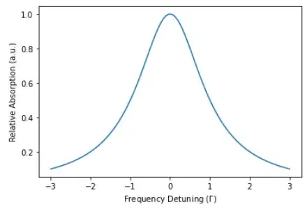

How do atomic clocks work?
You may find this answer helpful in undestanding how atomic clock work. The basic idea of an atomic clock is you have individually seperated (in a thermal or ultracold gas) Cs atoms. You shine microwaves onto the Cs atoms. As you tune the frequency of the microwaves you will see that there is one frequency where the microwaves are most efficiently absorbed by the Cs atoms. As you tune the microwaves off resonance the absorption probability decreases. The shape of the absorption as a function of frequency might look like the graph below.
An atomic clock works by (1) shining microwaves through a sample of atoms (2) measuring the absorption as a function of frequency and then (3) setting the microwaves to be as close to resonance as possible given the uncertainty of the measurement of the absorption function. Once this calibration of the microwave frequency has been performed, the oscillation of the microwaves serves as your "clock". According to the SI definition of the second, we would realize the second by (1) performing the above calibration on the microwave generator and then (2) counting oscillations of the microwaves until we count to 9,192,631,770. In short: we perform microwave spectroscopy of the Cs ground state hyperfine transition and then count oscillation of microwaves calibrated according to that spectroscopy. State of the art atomic clocks are state of the art because they can perform the most accurate and precise spectroscopy in the world.
