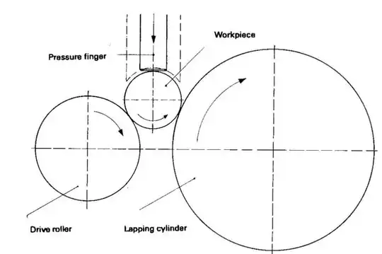

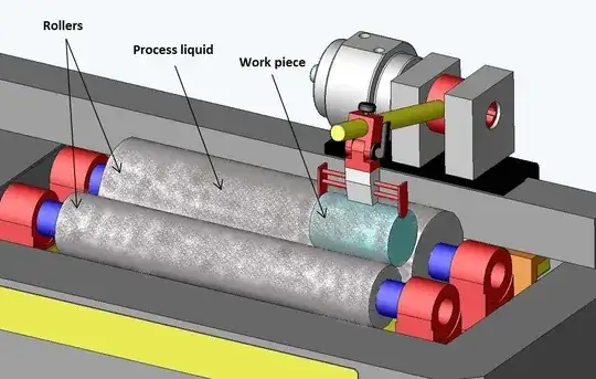

Centerless cylindrical lapping is a technique used to create a smooth and round cylinder through the use of microscopic abrasive compounds.
My question is a chicken and egg problem, because it seems to me that one would require perfectly round and smooth cylinders to begin with. Is there a requirement of a perfect cylinder to make a perfect cylinder?
