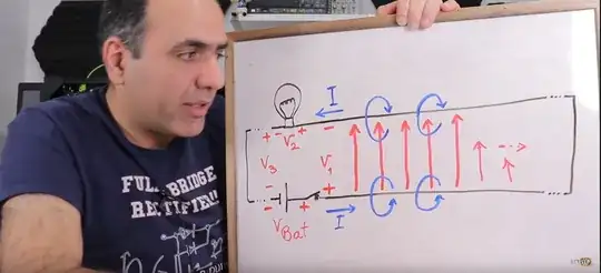

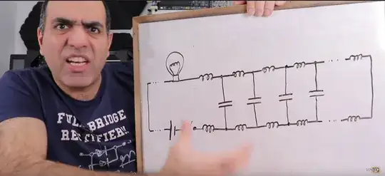

Part of the transmission line are parasitic capacitances in space between the two lines that the electric field can interact through through space. You could say that the initial current flows through that as it progresses down the line before it is established as actually flowing through the entire line. I believe physicists call this the "displacement current". enter image description here enter image description here You can try watching this and see if you understand it:
https://www.youtube.com/watch?v=iph500cPK28&list=PLlD-hnyodqSf7D9zPVviYaOaDZnWxkDYx&index=28
