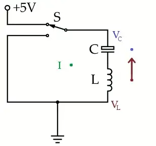

Here's a simple example:
a voltage source at top left, +5V, feeds into one of two selection terminals of a 3-pole selector switch S. The constant terminal of S connects to a capacitor C which connects to an inductor L, both at right. The inductor connects to a wire which is held at ground by a ground terminal; this wire then connects back around to the other selection terminal of S: the switch can either break the loop and connect +5V to ground through L and C, or else the switch can close the loop and remove the +5V source from the system altogether.
Here you see a capacitor $C$ in line with an inductor $L$ , held with a constant voltage that can be connected and disconnected with a switch $S$. Suppose that before the voltage is connected there is no charge or current in the system; everything will therefore be at the ground voltage. Now if you connect the voltage source, current will want to flow in, opposed initially only by the inductor, which resists changes in current but not the currents themselves. The relevant differential equations are that $I = C \dot V$ for the voltage across the capacitor while $V = L \dot I$ for the voltage across the inductor, where dots are time derivatives; these can be solved to find out that $I(t) = I_0 \sin(t/\tau)$ where this time constant for the oscillation is $\tau = \sqrt{LC}$ while the current constant is $I_0 = +5\text{V} \cdot \tau / L$. The basic physics here is that when the current across the capacitor has built up 5V of potential across it, so that the capacitor doesn't "want" to charge anymore, the inductor sees a current across it. Not liking changes in current, the inductor keeps the current constant and this pulls even more current out from the voltage source, overcharging the capacitor while the inductor slows down. The capacitor then discharges back into the voltage source, running the inductor in reverse.
In the following image I have animated the above analysis. Arrows for current point in the direction of the current; arrows for voltage point in the direction of increasing voltage.
Animated version of the prior image where we see a current going like the sine of t, and both the inductor and the capacitor have voltages going like the cosine of t, specifically 5 (1 - cos t) for the capacitor and 5 cos t for the inductor, so that they always sum to +5V.
So you see, we can analyze these sorts of things.
Now you can imagine what happens when we flip the switch back! If there is any voltage left on the capacitor, this thing will just cycle that charge back and forth, back and forth, around the loop forever, with the capacitor now picking up negative voltage, then positive voltage, and so on. In practice if you build this with real components those little resistances will eventually kill this perfect sinusoidal signal, of course, but we can easily imagine the resistances going to 0 and the resonator being this perfect eternal sine wave. No contradictions here.
