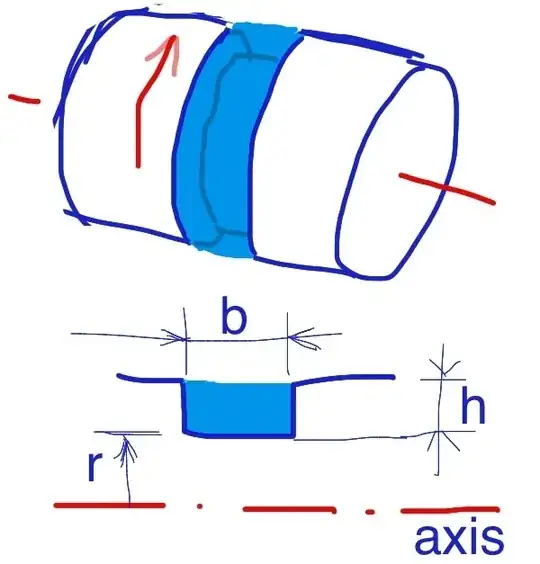

Let me try to answer the first question.
Suppose that in a spacecraft, water flows along a circular channel, the distance from the bottom of the channel to the axis of the circular channel is $r$, the width of the channel is $b$, the depth of the channel is $h$ (water depth is also $h$), the density of the water is $ρ$, the angular velocity of the water is $ω$, no viscosity, no friction, no water tension, and the air pressure of the spacecraft is $p$(lower case character).
Channel Bottom Pressure
What is the water pressure at the bottom of the channel? How to calculate?
Thanks to Chet Miller for the following answers:
$$P=p-ρrhω^2(1+h/2r)$$
The pressure at the bottom of the channel decreases with the increase of $ω$. Lower than atmospheric pressure (Note that the air pressure in the spacecraft is one atmosphere).

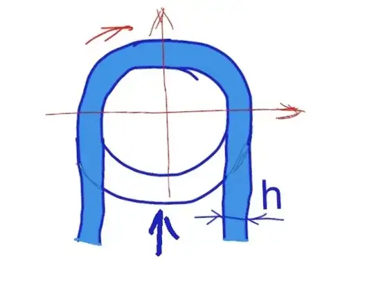

Fluid flows through the upper half cylinder
Assuming that the water flows only through the upper half of the channel, there will be an upward force acting on the cylinder because of the atmospheric pressure below the cylinder.
For simplification, suppose that the table tennis ball is a cylinder A, the radius of A is $r$, the weight of A is $w$, the cross section of pen body is rectangular, the width of rectangle is $b$, and the height is $h$. Suppose that the gas flows through the upper half circle of A with rectangular cross section. Then the upward force $F$ can be calculated by integral of formula.
When $F = w$, we can calculate $ω$.
Velocity $v$ can be calculated from $ω$ and $r$
Finally, it can be calculated that:
$$Q=vbh$$
The lifting force of table tennis is not because of Bernoulli's theorem, but because of the centrifugal force of fluid curve movement.
The centrifugal force of the fluid makes the table tennis surface produce low pressure, and the low pressure of the sphere makes the table tennis ball suspended in the air.
