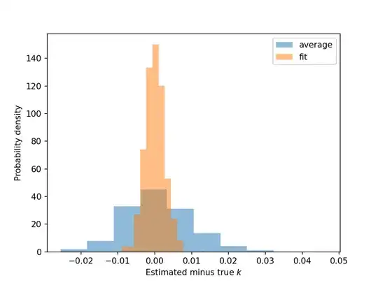

Here is the quantitative (simulation) approach @Dr. Momo was mentioning: we can simulate some points for $x_i$ and $F_i$, give them some Gaussian errors, estimate $k$ with the two approaches and see how close the estimates are to the true parameter.
The assumptions underlying this simulation are likely a decent approximation for simple tabletop experiments, but one must be careful when choosing the method to apply to a specific problem to check how the uncertainties are distributed - not everything is Gaussian in reality, and figuring out these distributions is tricky business!
With that out of the way: these two estimators, while both unbiased, differ in their variance (@user551504 has discussed the reason why).
histogram
The result looks like this: the normalization is irrelevant, but one can clearly see the errors are on average smaller with the linear fit approach.

I'll also note that the result is qualitatively the same even if errors are only included for $x$ or for $F$.
