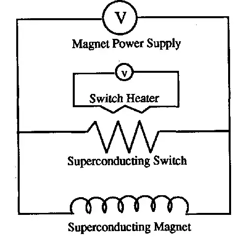

A way of exciting a superconducting magnet is explained below.
The switch heater, the superconducting switch and the superconducting magnet are immersed in a cryogenic liquid below the temperature at which the superconducting switch and the superconducting magnet become superconducting.
The heater is switched on and heats the superconducting switch to a temperature at which it is no longer a superconductor.
The magnet power supply is switched on and the current, passing though the superconducting magnet and not the superconducting switch, is slowly increased to the required value.
The heater is switched off and so the temperature of the superconducting switch drops until it becomes a superconductor.
The magnet power supply is switched off and a constant current passes through the circuit consisting of the superconducting switch and the superconducting magnet.

For some superconducting systems, that's exactly what they do (for example at CERN for magnets where a static field is needed (for example in some detectors). It's basically a "ring" of superconducting metal. Superconductors need to be below a certain temperature to be superconducting. So most of the ring is cooled down below that tripping point but one part is left "warm" (just above the required temperature). Then the current is introduced trough connections just before and after that "warm" piece. If the current has reached the desired value, it's held by the external source and the "warm" section is cooled down until it is superconducting too, thus closing the circuit. Over time the current is reduced (because changing the path of charged particles takes energy, so the energy from the magnet is slowly depleted) so the magnet has to be "restarted" again... The energies in those coils are enormous (We're talking GJ). So they have constructions to get rid of the energy within a second for example if for some reason part of the magnet is getting too warm. This means, for a short time, they send the current trough iron bars above ground and convert about 1GW of electrical energy into heat (that's equivalent to a small nuclear reactor). In other magnets, they have heaters to heat the whole magnet so the energy is dissipated over the whole length of the magnet in case of a quench event.
