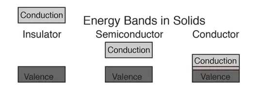

In the band theory of solids, a quantum model useful in studying solid state physics, electrons are bound in bands.
bandth
In metals, there are electrons in the conduction band, which are considered "free" to move through the whole metal lattice. They are very weakly bound to the solid metal. These electrons, when interacting with an incoming photon have a large probability to escape the solid .
So the interaction is not with a bound in an atom electron,(valence band) but with the almost free electrons of the conduction band.
