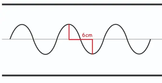

A microwave oven's microwaves have a half-wavelength of about 6 centimeters. While there are microwaves bouncing around in all directions and with all manner of offset origins inside the mirrored (for microwaves) interior of the oven, there's still a significant contribution to the energy deposited in the target that's from the primary beam.
A stick of butter is around 12 centimeters long. Therefore, it's highly likely that a randomly positioned stick of butter has exactly one maximum amplitude point located somewhere between the end points. This point will receive the most energy and melt first. Because butter has a very low melting point, it only needs to receive a little bit more energy to melt first, and because it's not in a rigid container, the melted part can puddle down and expose the part that was previously shielded from the radiation by the outer layer to the same maximum amplitude point.
This does not in any way contradict the claim that microwaves cook from the outside in. They simply cook from the outside-in slightly more where the primary wave direct from the magnetron is bigger. A working turntable helps to reduce this effect to make for more even heating across the whole target.

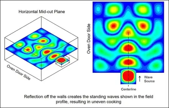

The whole reason why microwave ovens have turntables is that they always heat food unevenly because standing waves form inside them:
If a wave's antinode (where most energy is released) happens to be in the middle of your butter stick, the butter will melt in that place first, and may even explode if the temperature inside reaches the boiling point of water (there's often some water in the butter) before the sides of the stick have a chance to melt.
