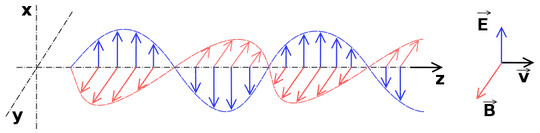

What happens is that an oscillating electron generates an electromagnetic wave, made of oscillating electric and magnetic fields. As the wave propagates through free space, there are no electrons involved at all, simply the fields jiggling around, following Maxwell's equations. Far from the circuit that generated the wave, the wave propagates like this picture from wikipedia
with the electric and magnetic fields perpendicular to each other, and to the direction of motion of the wave.
Eventually, the wave may interact with some charged particles, like electrons and the energy in the wave absorbed by the particles. In that situation, the electromagnetic wave will cause the charged particles to oscillate.
