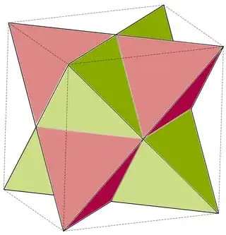

I run the risk to lose the reader if I use the duplicity of spin and magnetic dipole and ask the reader to consider the distribution of the electrons also as the distribution of their magnetic dipoles. But please, try it only once.
If you distribute the 8 electrons of the second and third shell to two tetrahedra pushed into each other, you get a frustration-free geometry. This is possible if the magnetic dipoles of the electrons are aligned to the nucleus. The 4 electrons of the one tetrahedron are directed with the north poles inwards. The dipoles on the other tetrahedron are then of course directed inwards with the south poles. enter image description here
This brings us back to Gilbert N. Lewis valence theory with his cubical atom.
