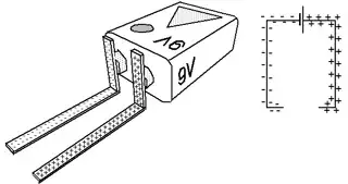

Let us take a simple example , a battery with two wires soldered so there is no surface between the pole and the wires. If we bring the two wires near each other , at a small distance a spark will happen ,a short, due to the migration of positive and negative charges over the distance between the two wires.
Contacts have been devised so as to be able to close the distance without sparking.The metallic surface of the contact,
contacts
allowing the charge transfer without sparking.
