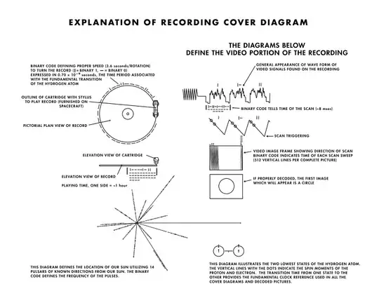

Yes, I would argue that 'fundamental quantities' are indeed arbitrary, as are many of our choices, such as base-10 number systems. This is illustrated well on the Golden Record we put on voyager spacecraft, for decoding by other intelligent life; we show how fast to spin the record by relating time units in the fundamental transition of the hydrogen atom:
Golden Record Instructions
I'd then add that we have tried to make them as least-arbitrary (to us) as possible, but there's no reason that some other intellegence would have different 'fundamental unit' definitions and scalings, or whatever 'arbitrary' units they came up with. We could use $ (time)^{-1} $ or 'period' as our fundamental timing unit, and change all the other derived units to follow, if we wanted.
