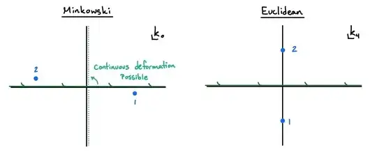

Note that $\Delta(k)$ has two poles in the $k_0$ complex plane, at $k_0=\omega (\vec k )-i\epsilon$ and $k_0=-\omega (\vec k )+i\epsilon$. The poles reside in the second and fourth quadrants of the $k_0$ plane. The $k_0$-integral in the propagator is along the real-axis, from $-\infty$ to $+\infty$.
In Euclidean signature (++++), the scalar propagator is given by:
$$\Delta_E(x-y)=\int \frac{d^4 k}{(2\pi)^4}e^{i k\cdot (x-y)}\Delta_E(k) \tag{3}$$
$$\Delta_E(k)=\frac{-1}{k^2+m^2}=\frac{-1}{k_4^2 +|\vec k |^2 + m^2} \tag{4}$$
In the Euclidean propagator, the poles appear at $k_4=\pm i\omega (\vec p )$, and the $k_4$-integral is over the real-axis.
It's easy to see that when $\Delta_{M,E}(k)$ are integrated over the $k_{0,4}$ variables, they are numerically equal, since one can continuously deform the contour in the Minkowski integral to obtain the Euclidean integral. I've even heard the Feynman diagram be called the "Euclidean" propagator, presumably for this very reason. This idea is illustrated in the picture below, which shows the $k_{0,4}$ integrals happening in their respective complex planes.

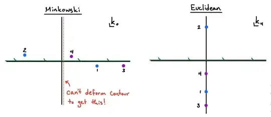

Now consider two momentum-space propagators multiplying each other, as one might naturally get in a loop diagram. In Minkowski signature this would look like
$$\int \frac{d^4 k}{(2\pi)^4}\frac{f(k)}{\left(k^2+m^2-i\epsilon \right)\left((k-p)^2+m^2-i\epsilon \right)} \tag{5}$$
where $f(k)$ is some regular function of $k$ (i.e. no singularities). Note that in the $k_0$-integral we will have 4-poles, 2 for each propagator. The poles coming from the second propagator will be shifted by $p$.
Now consider the equivalent "diagram" in Euclidean signature. Let's define $p^\mu = (p_1,p_2,p_3 , ip_4 )$ where $p_{1,2,3,4}$ are all real. This is the Wick-rotated $p^\mu$. We will get
$$\int \frac{d^4 k}{(2\pi)^4}\frac{f(k)}{\left(k^2+m^2 \right)\left((k-p)^2+m^2\right)} \tag{6}$$
The integrand again has 4 poles, but this time, because of $p$, the second propagator need not have poles symmetrically positioned on opposite sides of the imaginary axis. This prevents us from immediately Wick-rotating the Minkowski diagram into the Euclidean one. See the following picture.
So it seems the Euclidean answer will be wildly different than the Minkowski answer, but for a seemingly superficial reason. The fact that they will be wildly different can be seen by the fact that, assuming the $k_{0,4}$ integrals can be done by closing the contour in a half-plane and using residue theorem, pole-closing will give us different poles, when something tells me they should be the same. It seems that this is boiling down to the existence of poles in the first and third quadrants of in the $k_0$ Minkowski plane.

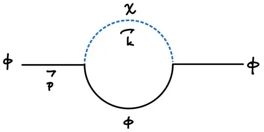

Let's consider a simple theory of two scalars $\phi,\chi$ in $d=2$ dimensions. Let each scalar have non-zero pole-mass $m_\phi,m_\chi$, and let the interaction simply be:
$$S_{\textrm{int}}=\int d^2x\, \frac{g}{2!} \phi^2 (x)\chi(x) \tag{1}$$
Consider the one-loop contribution to the two-point function coming from a $\phi-\chi$ loop, as illustrated below.
In Minkowski (mostly plus) signature, this (amputated) contribution is given by:

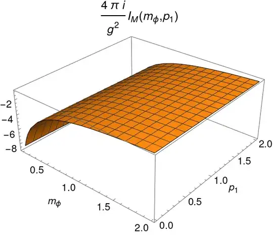

$$I_M(p^2)=\frac{-ig^2}{4\pi}\int_{-\infty}^{\infty}dk_1 \left[\frac{1}{\omega_{k}^{\chi}\left(\left(\omega_{k}^{\chi}+\omega_{p}^{\phi}\right)^2-\left(\omega_{k-p}^{\phi}\right)^2\right)}+\frac{1}{\omega_{k-p}^{\phi}\left(\left(\omega_{p}^{\phi}-\omega_{k-p}^{\phi}\right)^2-\left(\omega_{k}^{\chi}\right)^2\right)}\right] \tag{6}$$
A plot of this function is shown below. As required, the result is only a function of the invariant masses $m_{\phi,\chi}$, i.e. it is independent of $p_1$. (below I set $m_\chi = 1$)

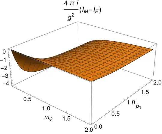

$$I_M-I_E\equiv \Delta I =\frac{-ig^2}{4\pi}\int_{-p_1}^{p_1} dk_1 \frac{1}{\omega_{k}^{\phi}\left(\left(\omega_{p}^{\phi}-\omega_{k}^{\phi}\right)^2-\left(\omega_{k+p}^{\chi}\right)^2\right)} \tag{9}$$
A plot of this difference is shown below. Again, $m_\chi=1$.
Note that it is not zero! Not only that, but it depends explicitly on $p_1$. Clearly, $I_E$ does not represent a physically relevant quantity.
