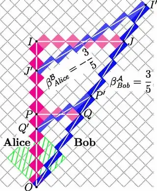

To amplify @AndrewSteane 's answer, with "ticks" and "space-ticks" ("sticks") and to help visualize Minkowski spacetime (a nonEuclidean geometry), I've drawn in what I call light-clock diamonds on a spacetime diagram drawn on "rotated graph paper".
You can now read off the tick marks for each observer.
Velocity is rise/run: $v=\Delta x/\Delta t$ in each frame, both agreeing on the forward direction.
robphy-RRGP-symmetry
