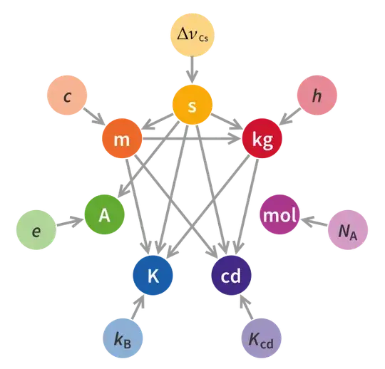

What you suggest is not really a simplification. Perhaps you confuse the SI base units and the SI derived units. The SI base units are a set of seven units from which all SI derived units can be derived (hence their name). The base units are defined by relating them to measurements of fundamental constants. The unit of Volt that you mention, is a derived unit which can be expressed in base units as kg m$^2$ A$^{-1}$ s$^{-3}$.
In addition, if you look at the SI base units and how they relate to the fundamental constants, you see that linking the mole to the Ampère, does not really simplify things. One still need a link to the electric charge of the electron and the hyperfine splitting of Cs.
enter image description here Image from Wikipedia.
