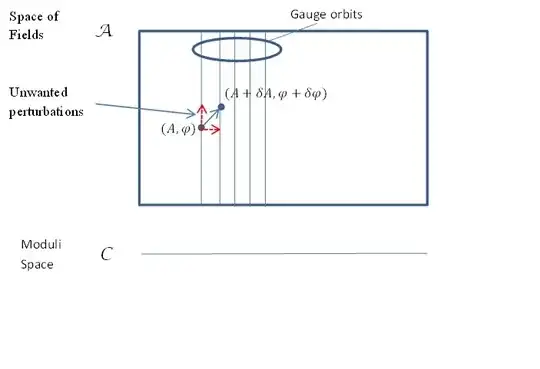

Now, for the purposes of identifying tangent vectors to the moduli space (fields modulo small gauge transformations), we want a way to filter out any infinitesimal perturbation of a solution $(A_i, \Phi)$ which is just given by an infinitesimal gauge transformation. An unwanted perturbation of this type would be of the form $$(D_i\Lambda, [\Lambda, \Phi]) \ \ \ (3)$$ where $\Lambda$ is some arbitrary Lie algebra valued function.
Now we can define an inner product on the space of fields. For a pair of infinitesimal perturbations $(\delta_{\alpha}A_i, \delta_{\alpha}\Phi)$ and $(\delta_{\beta}A_i, \delta_{\beta}\Phi)$ of a field (i.e. tangent vectors at the point representing the field) we can define their inner product $$ (\delta_{\alpha}A_i, \delta_{\alpha}\Phi)\cdot(\delta_{\beta}A_i, \delta_{\beta}\Phi)\equiv \int d^3x \{Tr(\delta_{\alpha}A_i\delta_{\beta}A_i)+Tr(\delta_{\alpha}\Phi\delta_{\beta}\Phi)\}$$Suppose then we look for perturbations orthogonal to the unwanted transformations of the form (3) - see the diagram below.$$ 0=(\delta_{\alpha}A_i, \delta_{\alpha}\Phi)\cdot(D_i\Lambda, [\Phi,\Lambda])$$ $$=\int d^3x \{Tr(\delta_{\alpha}A_iD_i\Lambda)+Tr(\delta_{\alpha}\Phi[\Phi,\Lambda])\} $$Integrating the first term by parts (assuming $\Lambda$ vanishes at spatial infinity), and using the cyclic property of trace on the second, our condition for orthogonality becomes $$ \int d^3x \{Tr(D_i(\delta_{\alpha}A_i)\Lambda)+Tr([\Phi,\delta_{\alpha}\Phi]\Lambda)\} =0 $$But this is ensured by our background gauge condition (2), so this is indeed the condition for filtering out the unwanted transformations.
