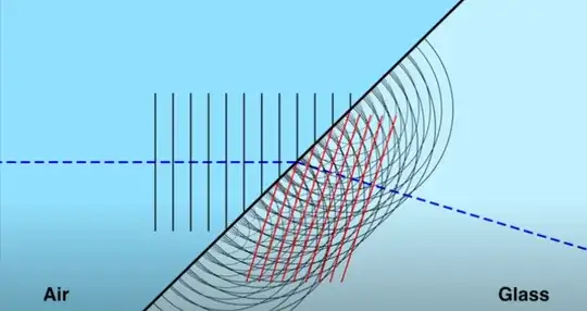

According to the old explanation the waves add up and move at at different angle due to slowed speed. It looks somewhat like this - (image from the vid)

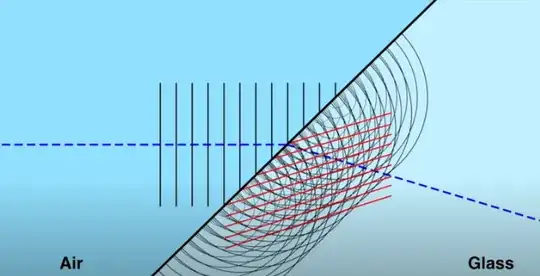

But there are also other wavefronts adding up together and going different ways.
like-enter image description here
So with different wavefronts aligning in different direction, many waves propagate in different directions and this is not observed in reality and hence this explanation proves wrong. Now, Doctor Don explains that we can consider the electric field components of the waves and deuce change on them on entering a medium. Since the surface is shared by air and medium, two set of Maxwell's equation are formed and equated- (each for air and medium)enter image description here

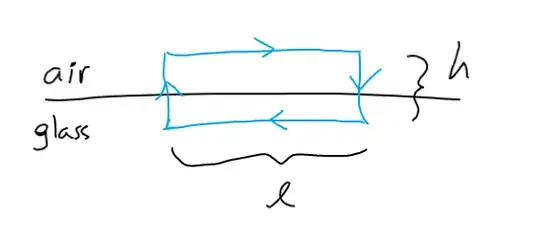

To show our claim, we will use Ampere's law. At the air-glass interface, consider a rectangular loop $C$ of height $h$ and length $\ell$ half-way between the the two media as depicted below.
By Ampere's law, we have $$ \oint_{C} \vec{B}\cdot \text d\vec{l} = \iint_{S} \mu \left[ \vec{J} + \epsilon\frac{\partial\vec{E}}{\partial t} \right] \cdot \text d\vec{A} $$ where the right-hand side is an integral over the rectangle whose boundary is loop $C$. The absolute value of the area integral on the right-hand side is bounded above by $\text{|maximum of integrand|}\times \text{Area}$ where $\text{Area} = h\ell$. As we send $h\rightarrow 0$, we see that $\text{Area} = h\ell\rightarrow 0$, so the area integral in the above equation goes to zero. Hence in the limit of $h\rightarrow 0$, we have $$ \oint_{C} \vec{B}\cdot \text d\vec{l}\rightarrow 0. $$ Thus, $\vec{B}(z\rightarrow 0+)\cdot \text d\vec{l}_{1} + \vec{B}(z\rightarrow 0-)\cdot \text d\vec{l}_{2} = 0$ for any length element $\text d\vec{l}_{1}$ parallel to the surface. Since the loop goes in opposite directions above and below the surface, $\text d\vec{l}_{1} = -\text d\vec{l}_{2}$ and thus $\vec{B}(z\rightarrow 0+)\cdot \text d\vec{l}_{1} + \vec{B}(z\rightarrow 0-)\cdot (-\text d\vec{l}_{1}) = 0$. Since we can orient the length element $\text d\vec{l}_{1}$ any way we want as long as it is parallel to the interface surface and since $\vec{B}$ is parallel to the interface surface in $p$-polarized light, it follows that $\vec{B}(z\rightarrow 0+) - \vec{B}(z\rightarrow 0-) = 0$, and so $\vec{B}(z\rightarrow 0+) = \vec{B}(z\rightarrow 0-)$, as desired.
Thus, $\partial\vec{B}/\partial t$ is the same as $z\rightarrow 0+$ and $z\rightarrow 0-$. The behavior of $\vec{B}$ does change as you pass from air to glass, but we've shown that it is same at the boundary, meaning it is continuous as you pass through the boundary. This is exactly the same way the parallel component $\vec{E}_{\text{parallel}}$ of $\vec{E}$ is same at the boundary and continuous across the boundary, as the video claims. In fact, a similar proof of this can be devised using Faraday's law.
