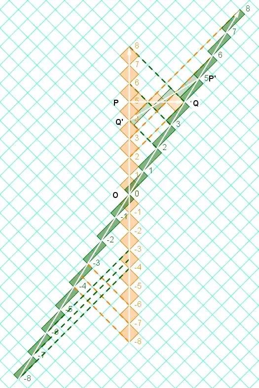

This spacetime diagram may help. The diamonds represent the light signals in a light-clock. The resulting diamonds give us a graphically accurate visualization of the ticks of time and space according an observer. The rotated graph paper helps us draw these diamonds for different observers.
I use =(3/5) to make the arithmetic easier.
robphy-RRGP-passingTravelers-Doppler
It was somehow arranged that two astronauts will pass each other inertially so that they meet briefly when they turn 30.
They broadcast their clock readings on their birthdays before and after the meeting.
What does each astronaut see (visually), based on the transmitted signals from the distant clock and the local clock?
Before they meet,
each astronaut receives two transmissions for every one year.
This is akin to blueshift... a shorter period between receptions of birthday-images... a higher frequency of receptions.
Specifically:
Before they met
  • at age 26, the image from the local clock is 26 but image from the distant clock is 22.
  • at age 27, the image from the local clock is 27 but image from the distant clock is 24. (The distant clock's image of 23 was seen at age 26.5.) ... and so on.
When they meet,
  • each astronaut receives "30" from the local clock and the distant clock.
After they met,
  • at age 34, the image from the distant clock is 32
  • at age 35, the image from the distant clock is 32.5
  • at age 36, the image from the distant clock is 33 ... and so on.
After they met, each astronaut now receives one transmission for every two years.
This is akin to redshift... a longer period between receptions of birthday-images... a lower frequency of receptions.
