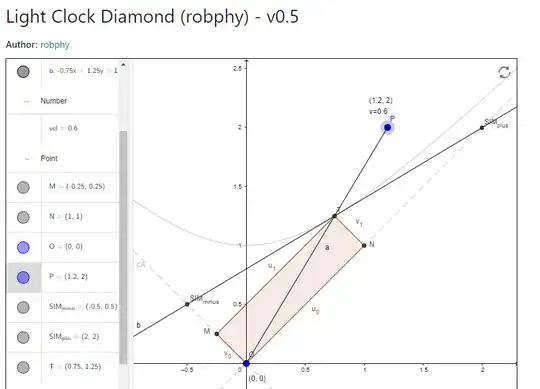

--------UPDATE------
For an interpretation...
The lack of symmetry in your two transformations is a result of maintaining the invariance of the interval, which is geometrically realized as the invariance of the area of this "diamond" (since the determinant of a boost is 1).
Have a look at my visualization https://www.geogebra.org/m/Jq4jDMRW
where velocity=3/5 corresponds to a Doppler factor $k=\sqrt\frac{1+v}{1-v}=2$..
a stretch of the forward light segment by 2 and shrinkage of the backward light segment by 2. robphy-RRGP-clockDiamond-geogebra
It might be enlightening to think in terms of rapidity $\theta$,
where $v=\tanh\theta$ and $\gamma=\cosh\theta$ and $k=\exp\theta$. (Note that $e^{-\theta}=\frac{1}{e^\theta}$.)
robphy
