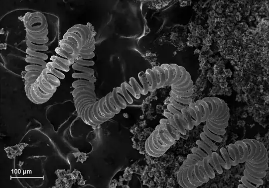

Heat experiences thermal resistance so the heat from the filament takes time to push its way down the glass encapsulation around the leads. It's also leaking heat from a very small mass (the filament) into a large mass (the glass, base, etc), and it has only a very small contact area where heat can conduct down to the base, effectively not much more than the cross-section of the filament, which is extremely thin. Remember that incandescent filaments are usually coiled coils (double-coiled), so they look much thicker than the actual wire used to construct them. Stretched out, a 60W incandescent filament would be over half a meter long (or about 20 inches) and is only 46 microns in diameter, which is about the thickness of a human hair.
SEM Image of coiled tungsten filament Image : Дагесян Саркис Арменакович, Wikipedia CC BY-SA 4.0

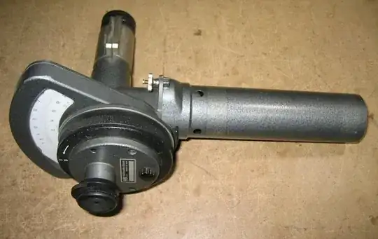

There is a type of measuring instrument used to measure the temperature at incandescent temperatures- called an "optical pyrometer" or, more specifically, a "disappearing filament pyrometer".
A filament, much like the filament in a bulb, is optically overlaid over the material to be measured (it should be similar to a black body, with an emissivity close to 1). The filament current is adjusted by the operator and when the temperature of the filament "disappears" the operator can assume the temperature matches the filament temperature and read off the measured temperature from a chart.
I have used these instruments and they are capable of reasonable accuracy with care, specifically the below type (from an eBay photo): enter image description here
Somewhat disturbingly, they are now called collectible museum pieces.
