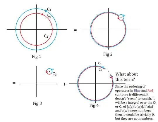

Let's say we have two operators $a(z)$ and $b(w)$. Let us fix the point $w$ somewhere in the plane. Define two circular contours $C_1$ and $C_2$ around the origin such that the point $w$ sits in the annular region made by $C_1$ and $C_2$. Now define two integrals $\int_{C_1}a(z)b(w)dz$ and $\int_{C_2}b(w)a(z)dz$ and subtract them (contours shown in fig 1) as $$\int_{C_1}a(z)b(w)dz - \int_{C_2}b(w)a(z)dz.$$
Then morph the loops from fig 1 into those of fig 2 by moving the red and blue loops close to each other without changing the order of the operators (in order to maintain radial ordering). Finally, I break the integrals of fig 2 into two pieces, one piece is shown in fig 3 and the other one is in fig 4.
My question is this: Why do we neglect the integral corresponding to fig 4? In the limiting case where the blue arc $C_4$ and the red arc $C_5$ come very close, the integral corresponding to figure 4 should be $$\int_{C_5 \to C_4} [a(z),b(w)]dz.$$ Isn't the integral of fig 4 the major contributor to the commutator $\left[A,b(w)\right]$? If so, wouldn't the contribution of integral in fig 3 go to zero in the limit where $C_3$ shrinks to point $w$ because then fig 4 will become the entire commutator?
The OPE $${\cal R} a(z)b(w)~=~\ldots$$ is often a regular function for $z\neq w$, so then the contour in OP's Fig. 4 is zero. In fact the OPE is typically a truncated Laurent series in $z$ around $w$, cf. Ref. 1.

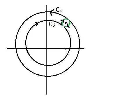

But what about the limit when $C_3$ shrinks? Wouldn't the integral $$\int_{C_5 \to C_4} [a(z),b(w)]dz$$ become exactly equal to the commutator? In that case, there will be another contribution to fig 4 which was irrelevant up till now. That term is the green part in the figure below. Once $C_3$ starts to shrink, this green "almost" circular contour will start to get a significant contribution which would be exactly enough to cancel out the $\int_{C_5 \to C_4} [a(z),b(w)]dz$enter image description here
When $C_3$ was a finite-sized circle, although the green contour should have been there in principle, it was easily neglected since we could make $C_4$ and $C_5$ very close to each other and because of the finite size of $C_3$, the green contour would be significantly far from the singularity $w$. Once we shrink $C_3$, the green contour comes closer to $w$ and gets a significant value.
