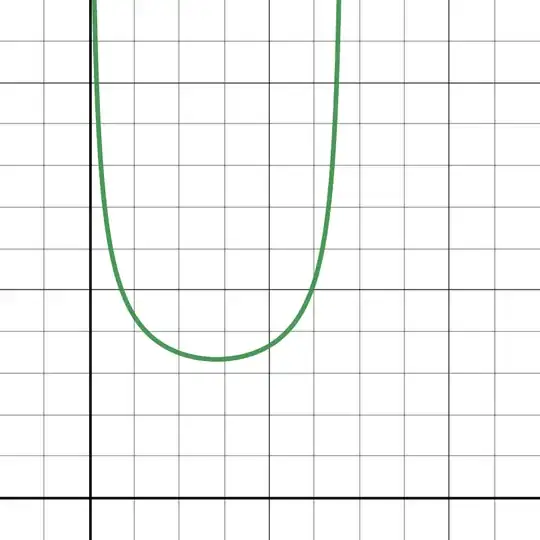

Bringing together everything, we find that $$E(\tau) = \frac{3 \pi (1 + H_0^2)}{4 \sqrt{1 + H_0^2 - \left(\tau - \sqrt{1 + H_0^2}\right)^2}}.$$
Plotting this expression on Desmos for $H_0 = 1$ (just so we can see the shape), we get the following figure: Graph depicting the shape of the total radiation energy as a function of cosmological time. It is shaped like and U: energy starts large, diminished to a minimum and then rises again. The graph is symmetrical about the minimum.
Hence, we see that the radiation's total energy density decreases and then starts increasing again. The minimum of the total energy density occurs when the Universe reaches its maximum size, and then starts to increase again when the Universe starts shrinking.
