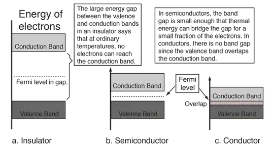

Your question iss within classical electrodynamics, whereas the electrons atoms and molecules belong to the quantum electrodynamics regime. One has to build quantum mechanical models that take into account that even though for single atoms electrons stay at specific energy levels defined by the potential between electrons and nucleus, the collective lattice composed of metal atoms has again a quantum solution that is approximated with quantum models.
In the band theory for solids
band theory
In terms of the band theory of solids, metals are unique as good conductors of electricity. This can be seen to be a result of their valence electrons being essentially free. In the band theory, this is depicted as an overlap of the valence band and the conduction band so that at least a fraction of the valence electrons can move through the material.
