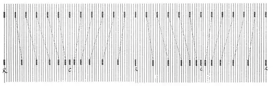

There are two ways of describing a sound wave: as a variation in pressure wave and as a mean displacement of particles wave as illustrated below.
. . . the excess pressure and displacement corresponding to the same sound wave vary by π/2 in term of phase . . .
. . . a displacement minima at the rigid end will be a point of pressure maxima. . .
So at a rigid boundary there is zero mean displacement whereas the variation in pressure is a maximum.
Which leads on to the statement,
This implies that the reflected pressure wave from the rigid boundary will have same phase as the incident wave, i.e., a compression pulse is reflected as a compression pulse and a rarefaction pulse is reflected as a rarefaction pulse.
If the phase change after reflection from a rigid boundary is π, . . .
This is for the displacement wave not the pressure wave.
Whereas for the pressure wave which is $\pi/2$ out of phase with the displacement wave there is no phase change at a rigid boundary.
